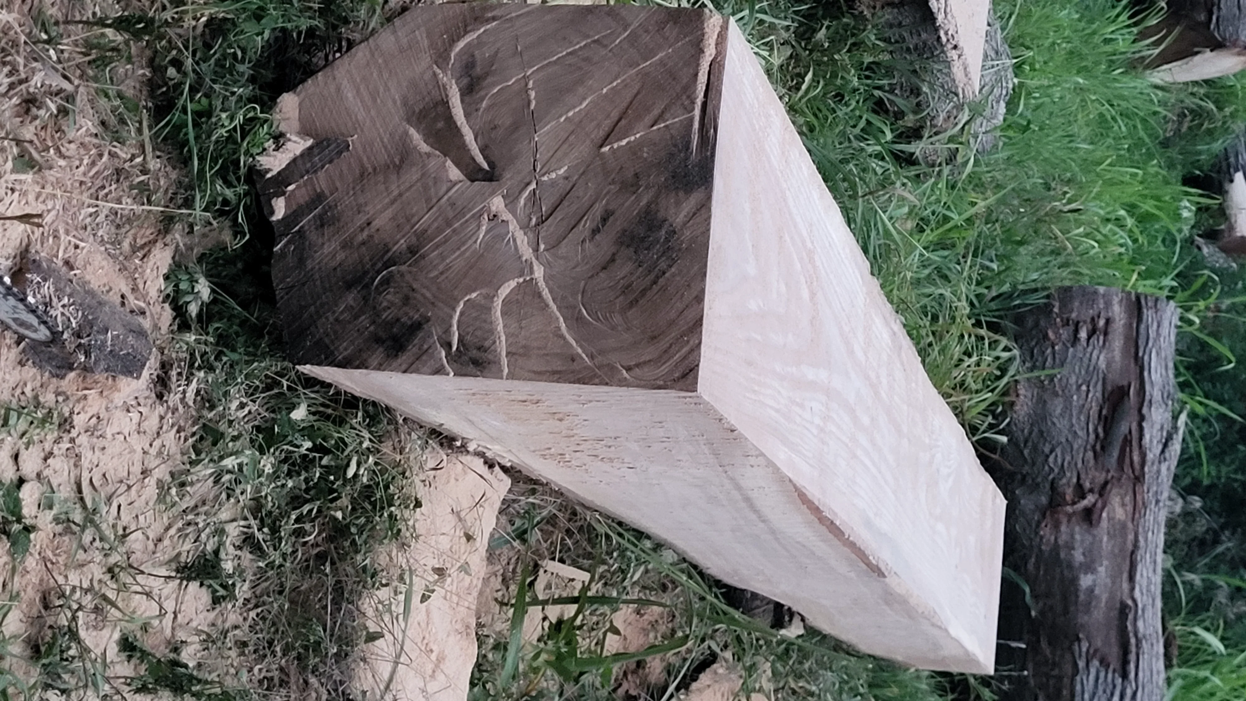

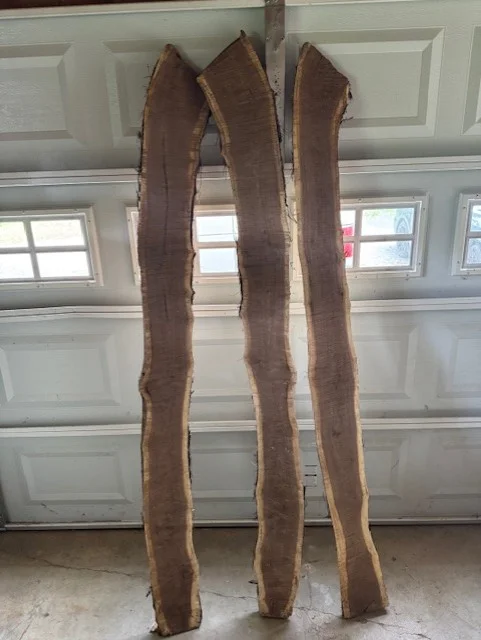

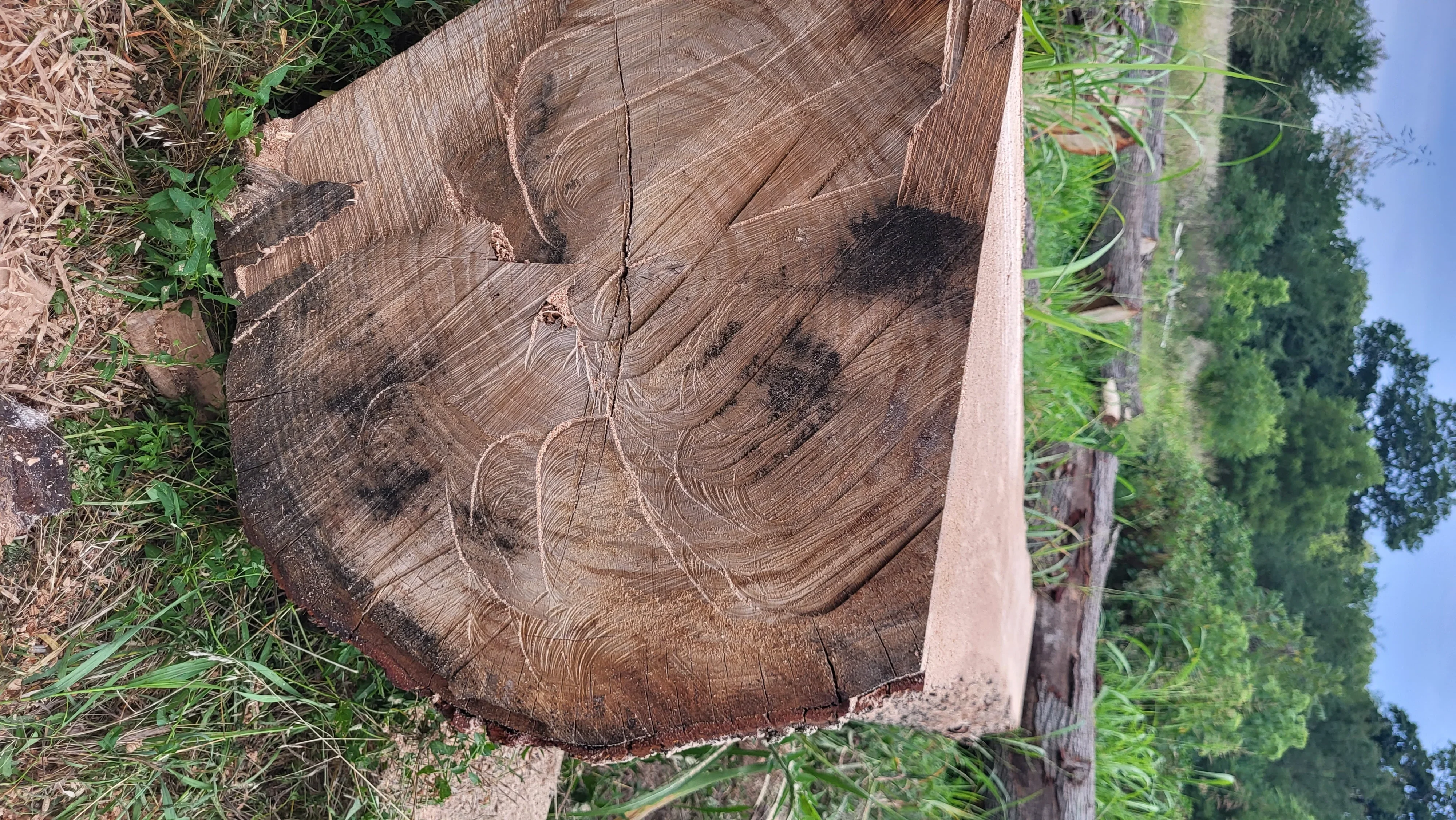

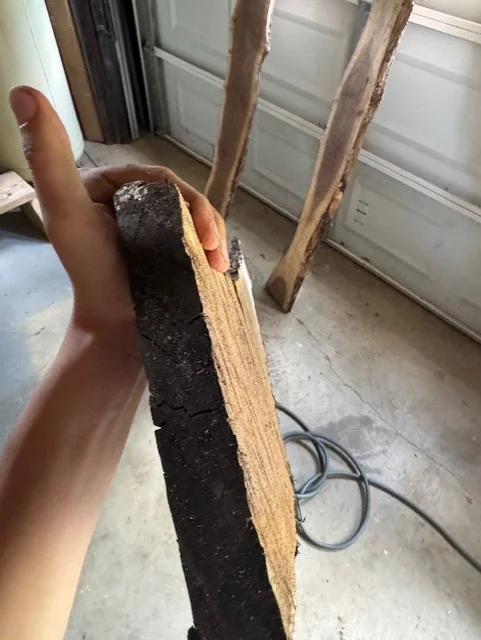

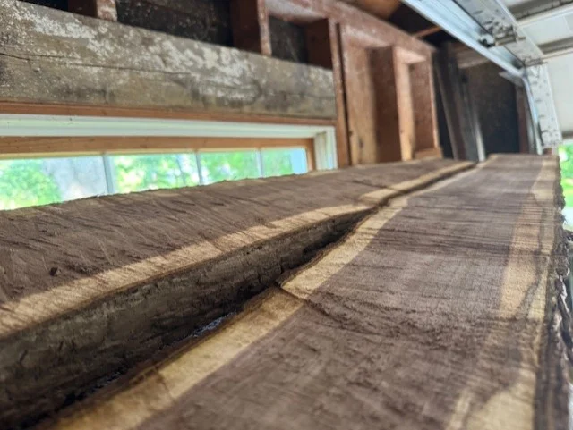

Here is some wood I have milled so far.

Those slabs were milled with an Alaskan? Maybe it's the picture but they look incredibly rough as if you used a monstrous amount of effort forcing the saw through the log. A lot of different cut angles too like you were using the dogs to force it through? I'm not poking at you at all, I'm just seeing some kind of serious cutting issue. Ripping chain will give you a cleaner, smoother cut than cutting chain. Angles are different on the top plate, usually 10° ripping, 35° cutting. But you have more than that going on if you used a mill. Cuts with a mill should be smooth and straight. Oak log pics. Notice the smoothness of the top (ripping) and the rougher appearance of the vertical cut (cutting chain on smaller different size saw and bar)
Honestly dont know why pics loaded sideways. Sorry. Guess you'll have to turn your device sideways
