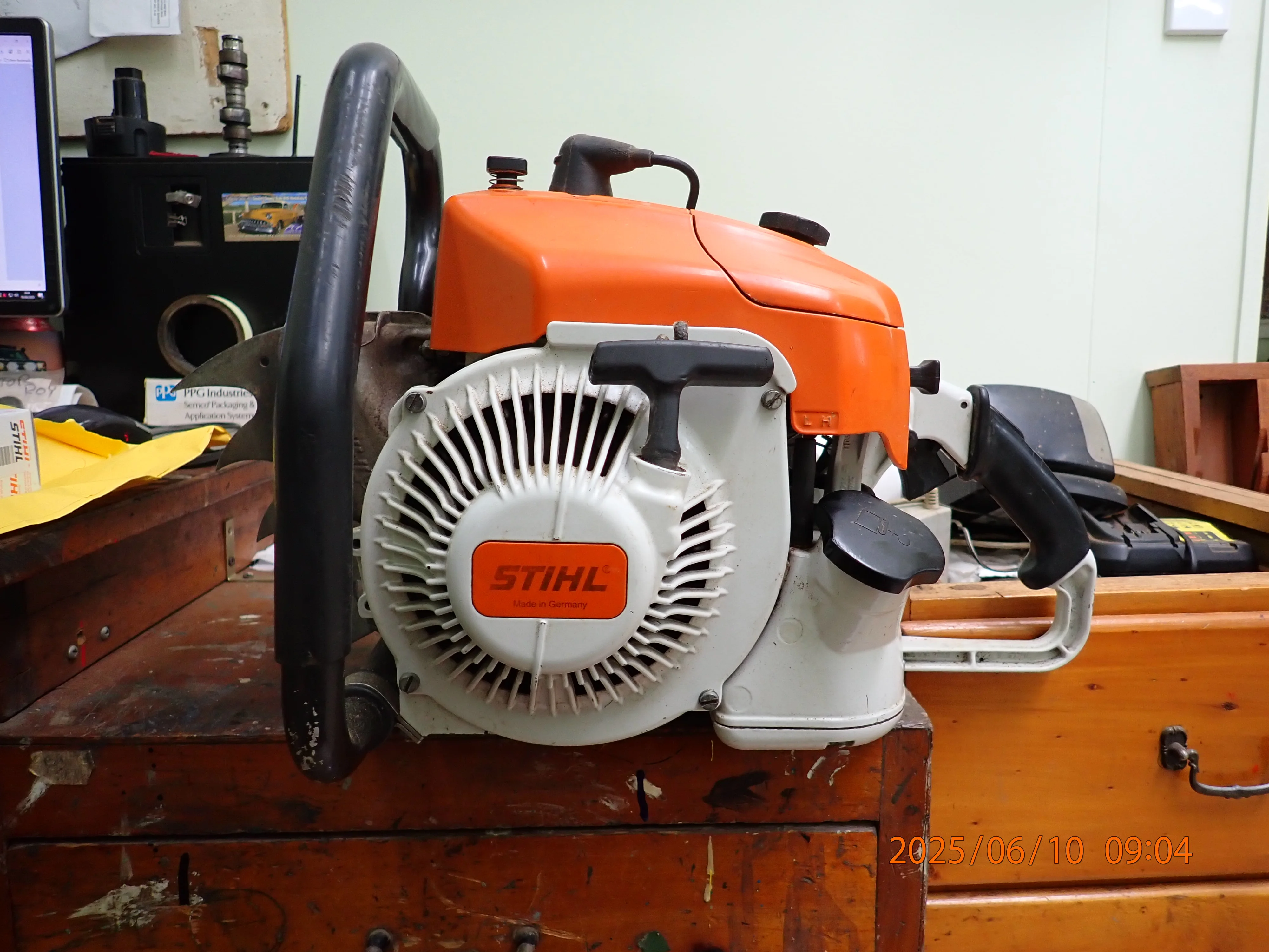

Yesterday a man brought me this very nice looking example of a MS720 to work on. Looks just like a 070/090 to me, are there any significant differences between the 070 and the MS720?
Guy says that it has not run in many years and he thought maybe the problem was the kill switch wire. That did not make sense to me so I told him I doubted that was the problem, but that I would look into it and let him know. Feels like it has great compression. I see quite a few of these, but usually they are labelled 070 or 090, and of course a number of the 070's have 090 top ends on them. I've also seen chinese clones available for sale in hardware stores in Lae, (usually in weird colors and with funny names on them like "Warrior" or some vaguely chinese sounding name) but so far I don't think any of those have been brought into the shop. Seen a few top ends brought in for spark plug hole repairs, but that's it.

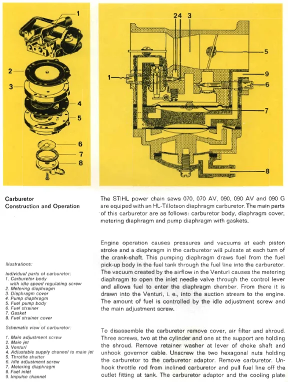

Pulse tube? Do you mean inside the carb? Everything looks super clean in the carb. Gas here is not like gas in other countries, it usually evaporates pretty clean doesn't leave a lot of goo behind. Usually. There was a short period a while back where the gas was like gas in the US, and left a huge mess behind when it evaporated. But this saw looks like it was last used before that time. There was some gum on the bottom of the fuel tank where the gas had evaporated and left the oil behind, but I cleaned all that out. I've had to put it aside to work on other stuff, but now I can get back to it.
The pulse tube conects the pump side of the carb to the crankcase it provides the alternating vacuum pressure pulses to pump the fuel to the carb
The pump side of the carb is the side with the diagram that has the cutouts

I replaced everything in the fuel system up to the carb--in other words, the in-tank filter, the line in the tank, the big plastic dooflicky that fits in that line at the top of the tank, and the line between that and the carb, all new, all genuine Stihl parts. I had the carb apart when the saw first came in and everything inside of it was clean and the diaphragm and other rubber parts appears to still be supple. I will open it up again. I'm glad it's a MS720, at least they are super easy to get the carb off of.

Passage 9 is the pulse tube it must connect to the crank case some how to provide alternating vacuum and pressure to pump the fuel
By the look of the diagram it may connect through the manifold this must be airtight . A common mistake is to have the gasket round the wrong way blocking the connection, There is a chance that this may be a rubber pipe /hose to connect the carb and the crankcase
