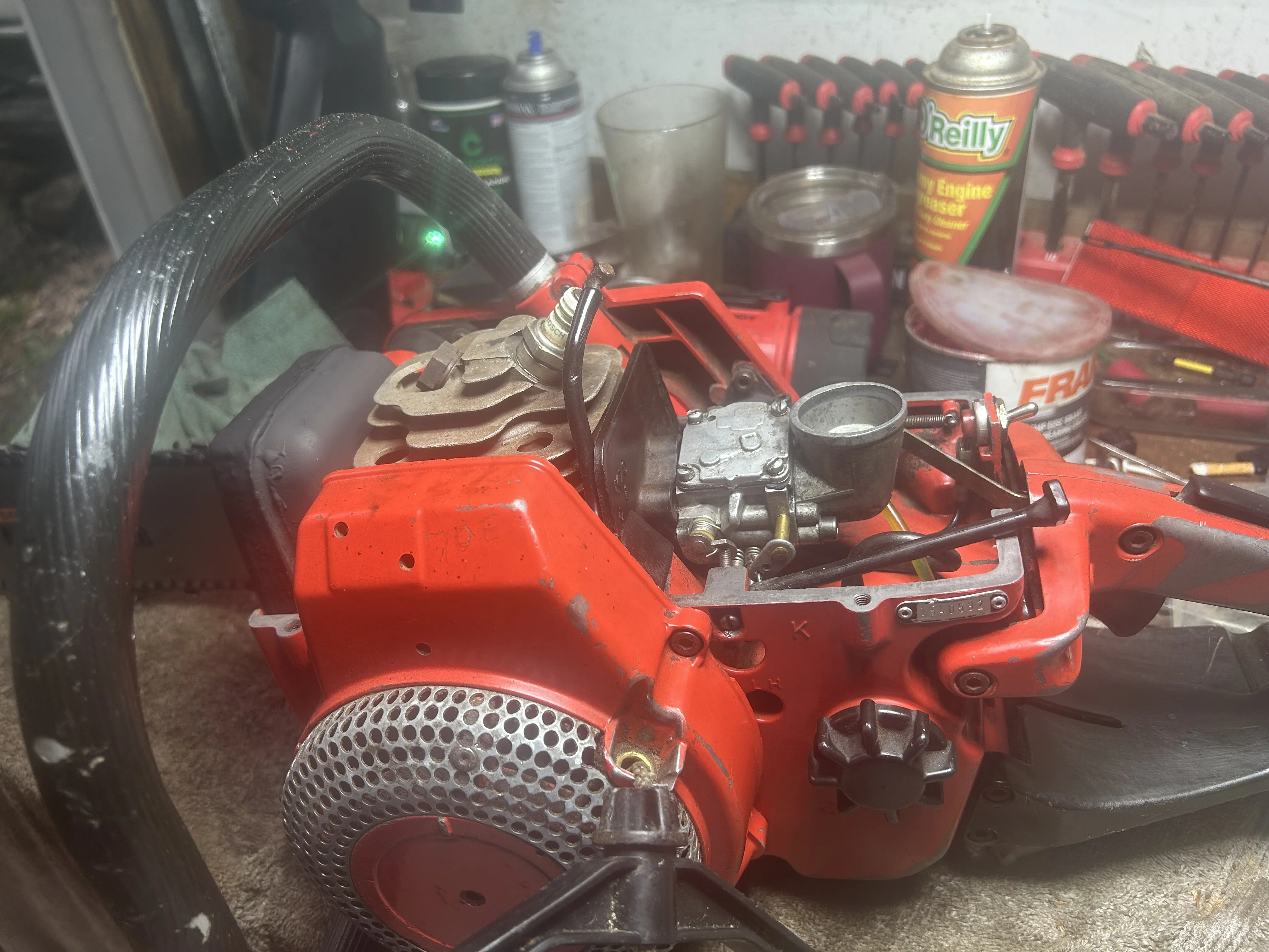

Denisc7503 Member Joined Jul 6, 2025 Messages 8 Jul 6, 2025 #1 Can anyone help me with I believe old jonsered 80??
Denisc7503 Member Joined Jul 6, 2025 Messages 8 Jul 6, 2025 #2 Attachments IMG_4005.webp 873.8 KB IMG_4006.webp 512.6 KB

Denisc7503 Member Joined Jul 6, 2025 Messages 8 Jul 20, 2025 #5 I found info on it 1981 70e, runs great, just waiting for top cover and filter! Was given to me

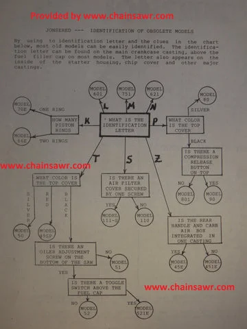

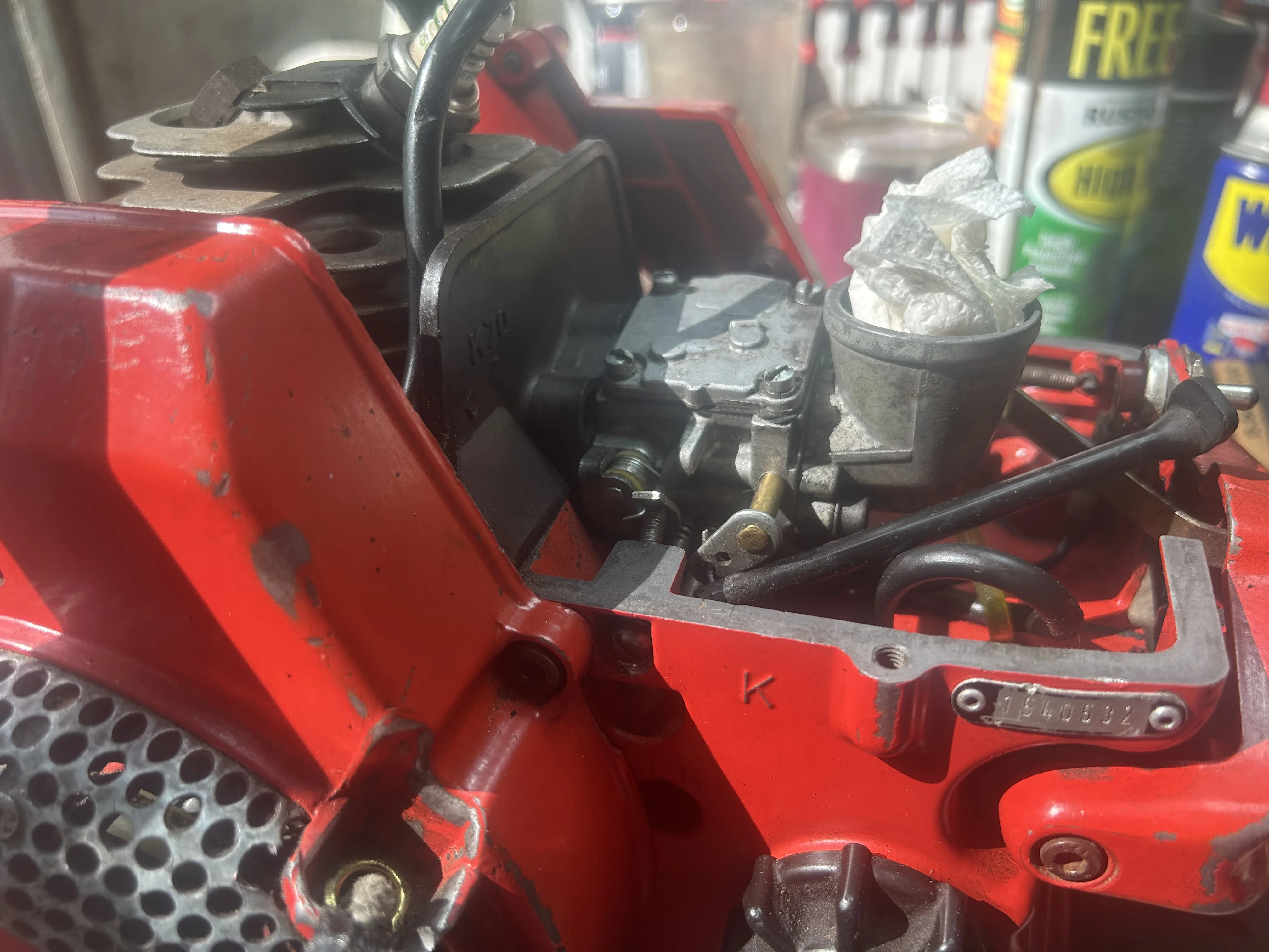

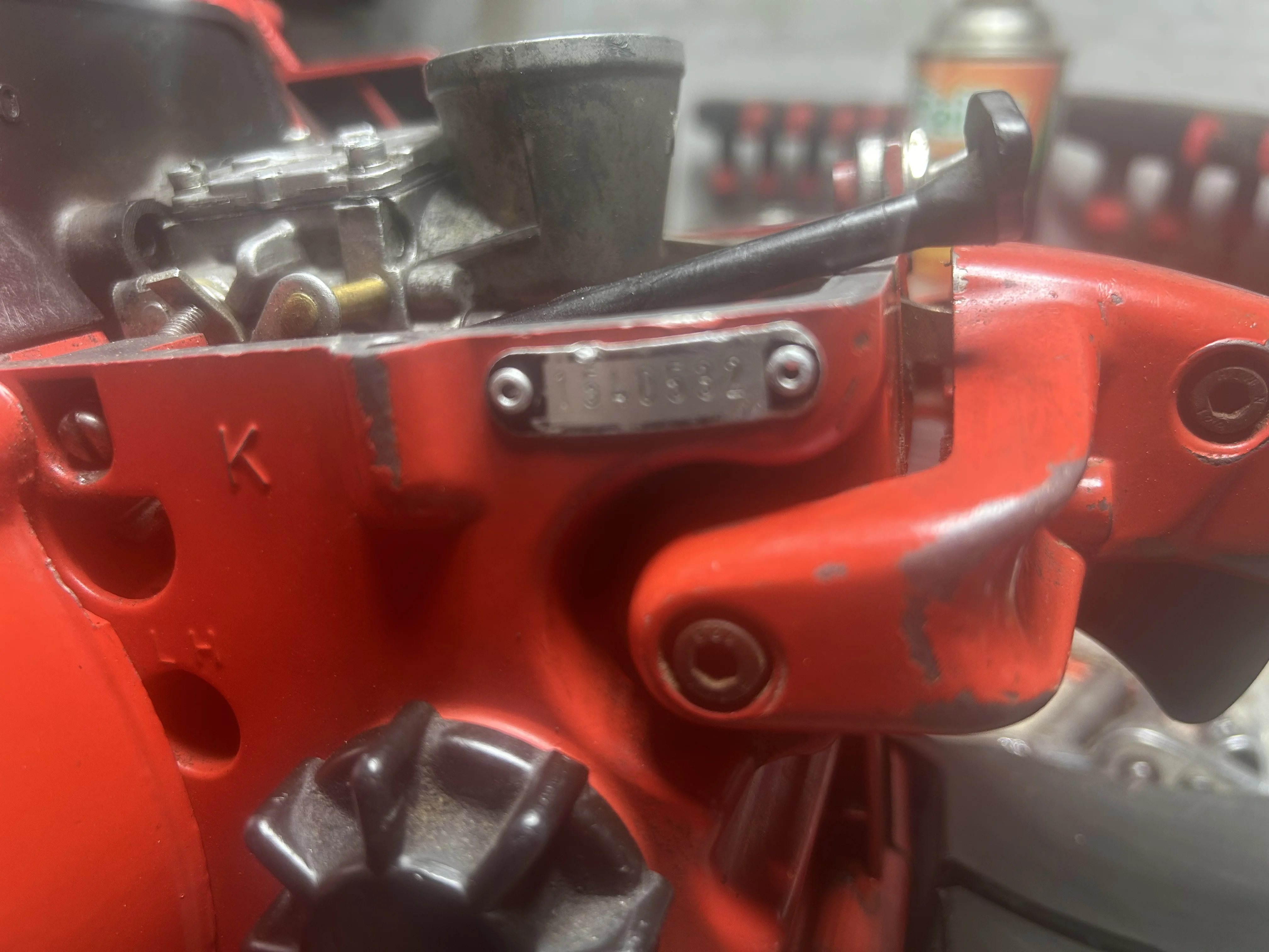

Denisc7503 Member Joined Jul 6, 2025 Messages 8 Jul 20, 2025 #7 Found it’s a 70e, u can identify by letter on crank side above gas cap
Denisc7503 Member Joined Jul 6, 2025 Messages 8 Jul 20, 2025 #8 above gas cap Attachments IMG_4029.webp 644.1 KB
Denisc7503 Member Joined Jul 6, 2025 Messages 8 Jul 20, 2025 #9 Hope this helps someone Attachments IMG_4067.webp 22.7 KB
