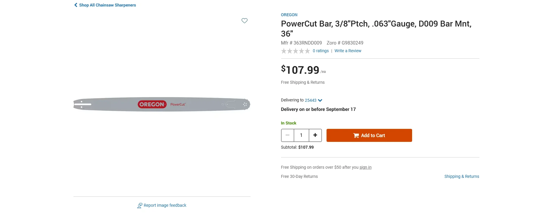

found this, it has though a at then end is that ok? my current bar does not I also should of specified that its for a 3120 clone shouldnt make a difference and I saw a video of a guy swapping the sprocet and bar out for a OME Husk bar.
I don’t see the A at the end, that you mention.
But it is a D009 mount which is the proper mount for a 3120XP.
Assuming that you are running 3/8” pitch, and .063 gauge chain, and your drive sprocket/rim drive is 3/8” pitch, that would be the right bar
